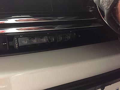

    Take a look at fitting and looming carefully a couple of high quality Rigid Industry 6 inchLED light bars behind the grill as per photo.
    Far far, far and away much better than Xenons which, by the way, are fitted to my other cars (along with light bars).
    Brilliant light output which goes almost forever (hyper spots) and is loomed, via relay into main beam.
    All up with professional fitting, including made to order brackets, less than a $1000, no coding, adjustable, far better light output = no brainer.
    I put a similar set up on my Audi SQ5 as the Xenons are just not as good as folk think on high beam.

    That's a very neat looking job Dingah. Tiguan Xenon Retrofit Part Numbers
