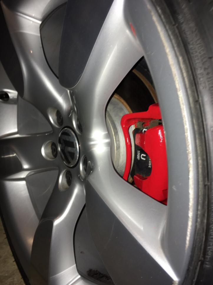

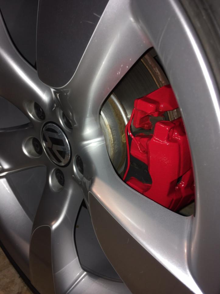

    Tig got a pedicure today:
    The calipers look great! Did you apply a base coat?

    Quote Originally Posted by Ceres_mining_co View Post
    Sent from my SM-G930F using Tapatalk
    No just cleaned with degreaser and then painted straight onto the bare metal.
    This was using Foliatec caliper paint which is a 2 part paint with colour and hardener that you mix up. It goes on with a brush and you have to use it within an hour or two before it goes off.
    I've used the VHT high temp rattle can stuff before and this gives a far superior finish (hard gloss). The VHT paint seems to attract brake dust and ends up looking pretty average after a few months.

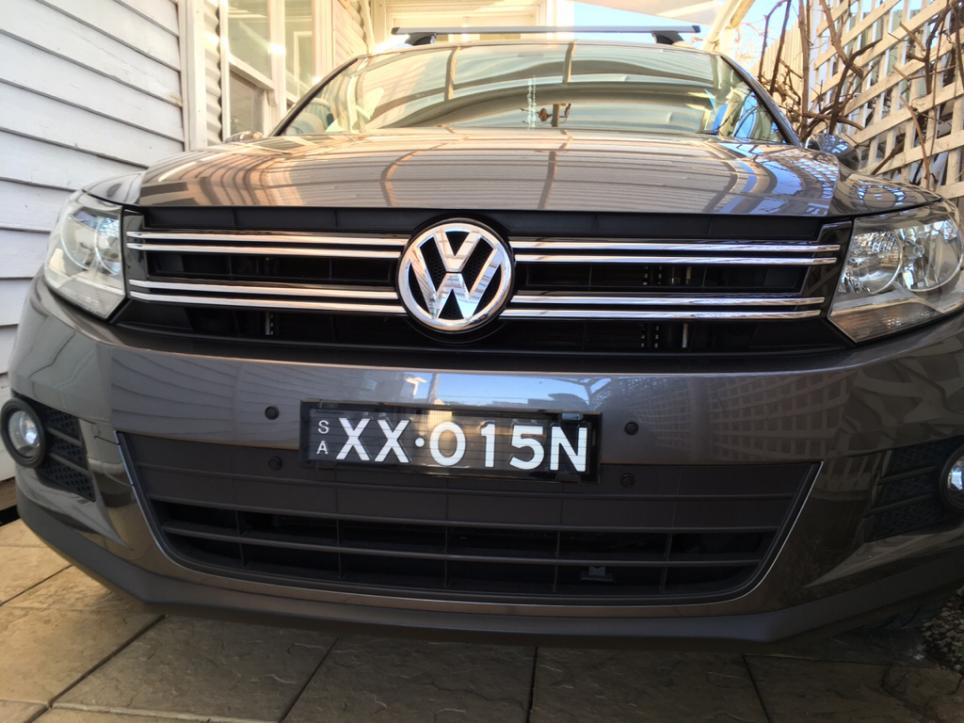

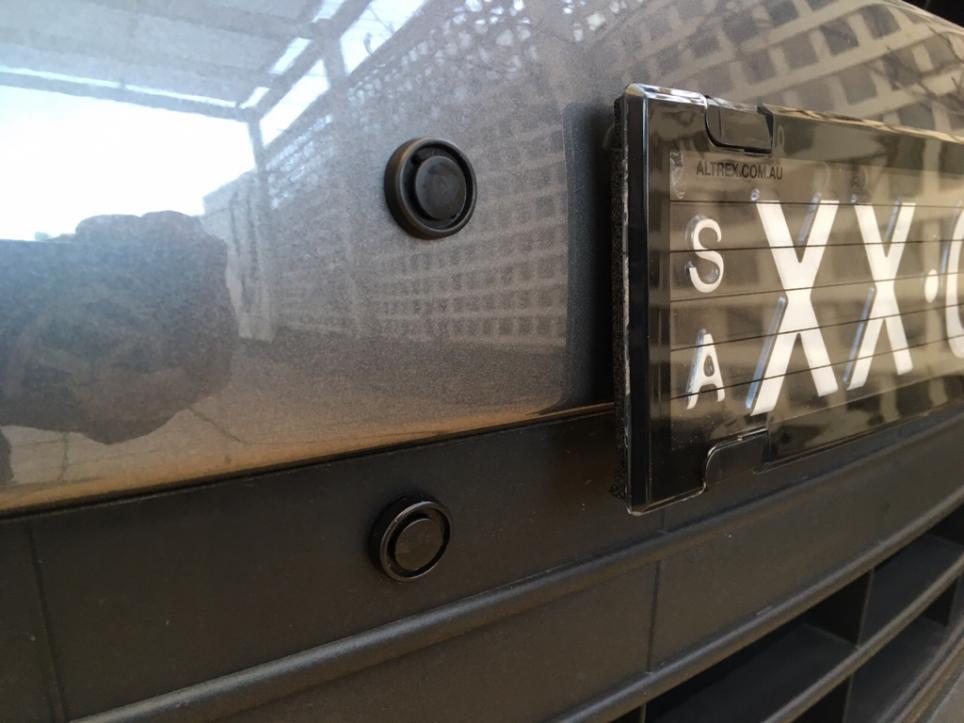

    Took off the front number plate mounting bracket. Just used some clips to fill the holes in the bumper.
    Looks good just wondering if those holes would fit the Reverse sensors but wired to the brake pedal ,that way you could park closer to the car in front or a wall ?
