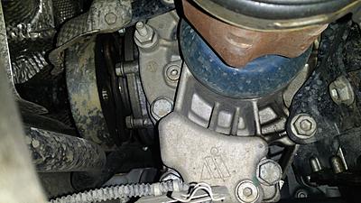

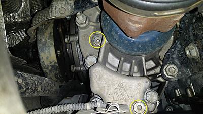

    Just wanted to make sure the the front diff fluid holes are the 2 hex key bolts in the image. Is that correct?

    Yep, that's them.
