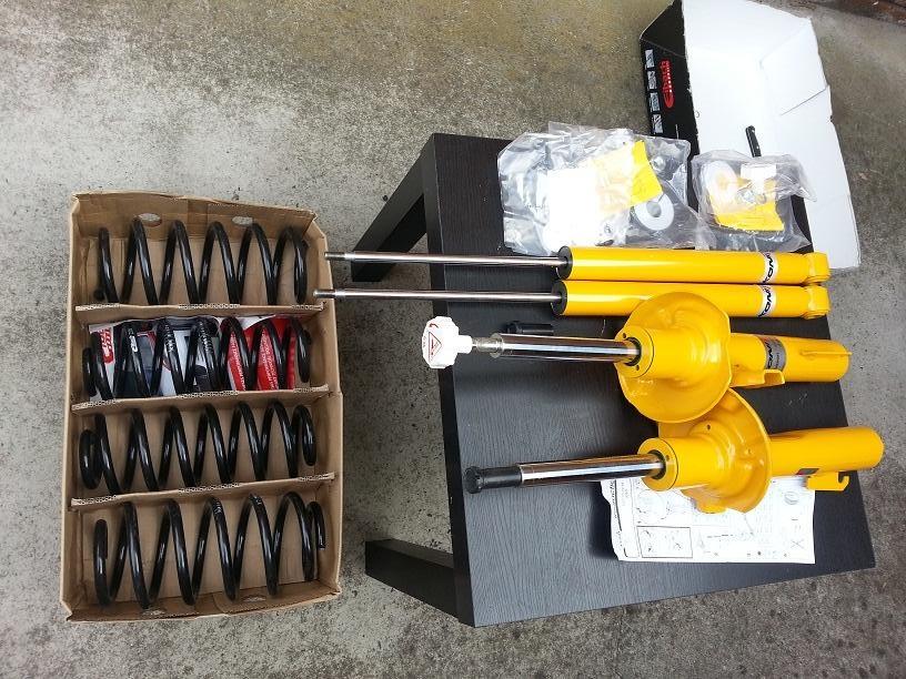

    Tig Suspension
    Today two parcels arrived to our door step It is also time to take out my Eibach Pro Kit spring set as well!
    Boxes contain Koni Yellow Sports front and rear shocks with rebound adjustability.
    With these installed I hope to lower the car around 35mm and improve the handling and comfort. Also I like to test the shocks with set of H&R springs as well so if someone has a set of H&R springs for Tig please let me know

    i have Koni Yellows with Eibach Pro-Kit on the Octavia. Beautiful ride control - especially initial movement. No stiction like the Bilsteins get.
    My mate has them on his polo with stock springs - transformed the vehicle.
    Recomend half a turn off soft as a starting point.

    Quote Originally Posted by brad View Post
    Good to hear and appreciate your advice Brad I can't wait to get these installed.

    These are the part numbers for Tiguan specific Koni Sport Yellow shocks..
    For the front - KONI 8741-1546 SPORT
    For the rear - KONI 8040-1395 SPORT
    Both front and rear can be rebound adjustable. but rear shocks need to be removed from the car to adjust.

    The Eibach Pro-kit springs work well and the Koni yellows seem to be best for rebound control - like MGV just waiting to wear out OE shocks before replacing mine with them also
