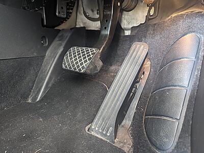

    Has the Tiguan got a floor mounted throttle pedal (like the Golf of the same era) or a more traditional top mounted throttle pedal? Either way the plug will be there somewhere. If its a floor mounted pedal then the plug may be under the carpet and require removal of the pedal to access?
    I installed a throttle controller on my TDI Audi SQ5 and it has a floor mounted throttle pedal, and the wiring harness for the throttle was visible and accessible just behind the pedal itself.
    A couple of clear photos of your cars throttle pedal would help.

    Yes, it is a floor mounted unit. There is a single torx bolt fastening it to the floor.
    I pulled the carpet away a bit and I think you are right that the connector is down at the pedal. I can't work out how to get the carpet out however...
    I'll get a photo for you

    Here you go.
