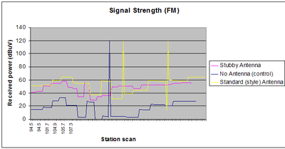

    Testing was carried out at the Shoko-Leibnitz Institut fuer Einfartforschung (Driveway Research) in suburban Sydney. Each antenna was fitted in turn and the 15 preset radio stations present in the receiver, spanning most of the FM band in Sydney, were selected for approximately 1s each. VCDS[8] was used to log Group8, Field1 ("Signal Strength - Tuner 1") to a comma-separated value (CSV) file. Values were graphed and averaged in MS Excel.

    RESULTS
    Average receiver signals were: Stubby 48.007dBuV (min 29, max 58 ), Standard 53.364dBuV (min 31, max 65) and No Antenna 16.884dBuV (min 0, max 33). Antenna selection had varying influence on signal strength for different radio stations: for some the difference was less than the average reported, for others much more. Full data set available on request.
    From whip to stubby: Aesthetic-driven antenna selection and performance.-antennas-png
    Figure 4. Data traces. First 5 stations are easily identified in each trace.
    DISCUSSION
    Antenna choice had a clear impact on signal strength delivered to the radio receiver. No antenna (which really means "only the wire to the mount as the antenna", i.e. no antenna extension) did actually result in at least one station being unreceivable. Powerful transmitters mitigated the effect of antenna selection somewhat, with both Austereo's 2MMM (104.9MHz) and the Australian Broadcasting Corporation's 2JJJ (105.7Mhz) least affected by selecting the factory Standard whip or aftermarket Stubby antenna. However one of the community stations could be received with a relative signal strength of 45dBuV on the Standard vs 35dBuV on the Stubby, a more than 8 times stronger signal.
    Anecdotal evidence often suggests one antenna may be "just as good" as another, or the original equipped by the factory[10]. Once the performance of modern audio hardware and digital signal processing software is taken into account, this data strongly suggests that, in reality, a Stubby or similar low-profile aftermarket antenna is actually simply making the radio receiver work harder to deliver the same performance. Users may not realise that they are driving the amplifiers in their stereo system harder, with all the heat dissipation, power consumption and component life degradation that entails to compensate for a poorer-performing antenna.
    In any case, the authors prefer the "glorified RC car" aesthetic lent by the Standard whip antenna fitted to the test vehicle, and can now smugly point to this research whenever ridiculed by someone with a metallic-wrapped sharkfin on their 400hp shopping trolley in the Oporto carpark.
