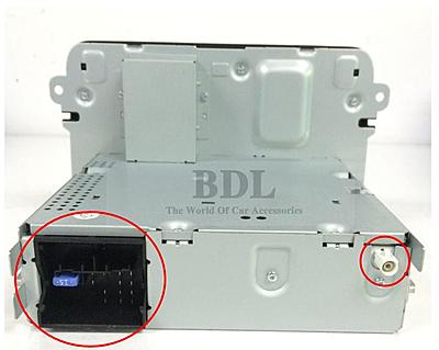

    Another question, the AliExpress seller gave me the supposed 'camera adpator' below
    Replacing RNS 510 with RCD 330+-cam-adapt-jpg
    Which doesn't seem to be the correct one, as everyone else with OEM camera's have been linking this - Volkswagen Factory Backup Camera RGB to RCA Video Output Converter
    Which one do I need?
    Also where does this plug into the head unit? As the only 2 plug points on the back of the head unit already have connectors attached (Left is the quadlock plug and right is the FM antenna)
    Replacing RNS 510 with RCD 330+-back-jpg

    Quote Originally Posted by golf2001 View Post
    thanks Kamold, appreciate your help!
    If you have an OEM camera with the 26 pin multimedia connector which connects to the RCD510/RNS510 then you need the RGBS to composite converter you linked.
    If you are using an aftermarket or MY16 Tiguan camera with composite video (single yellow RCA connector) then you use the adapter you circled, and put that blue square connector into the appropriate block in the quadlock harness.
    Any luck with the amp coding?
    I have the 26pin OEM camera, so I'll buy the connector I linked.
    I haven't tried to change the amp coding yet, as I don't have an obd11 or rosstech cable yet.
