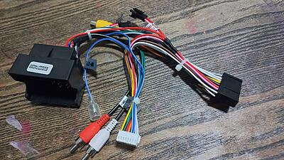

Here are some pics I took of the additional connector that came with the unit and the canbus decorder. This connector doesn't include the B0, B1 and B2 wires, but connector does not fit my car.

The additional harness that doesn't fit my vehicle. The only difference I can see is that there are 3 green wire pairs on mine B0, B1 and B2. No idea what they do and can't find any info on it.
The red/pink pair. The label says "To install no CANBUS connection" When disconnected, there's no power to the headunit
This green wire looks to be the only connector that goes from the CANBUS decoder plug to the main harness.
I forgot to mention, there are 2 blue Steering control wires that are terminated, but no idea where they go or how to use them
