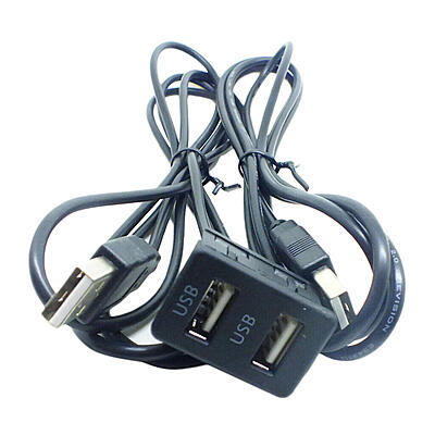

    What you need is a plug similar to this which can plug into the USB ports on the back of the aftermarket radio (Note OEM radios have no USB ports on the back).
    MIB2 Carplay USB Port question-non-oem-usb-jpg

    It looks like I either need to get a passive USB port from another model of car or look at complete aftermarket solutions like the last pic you posted.
