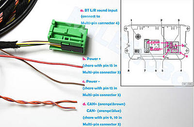

    I've noticed many are buying their bluetooth modules and wiring from overseas as the are significantly cheaper. For those who recieve the wires that are not plug-n-play and require splicing, here is a diagram to help you out t know which wires you need to splice
