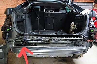

    I need to tap into the CANBUS High and CANBUS Low pins, so i can connect a TPMS (direct) controller module that i'm looking to retrofit.
    any help would b much appreciated.

    On the main unit (right side) CAN high is pin 3 (orange/grey) and pin 4 is CAN low (orange/brown) for extended CAN interface.
    Pins 6 and 7 are the private CAN connection between the 2 radar modules.

    yup, as u've mentioned, I got the same info from the Ross-tech forums. i tapped into pins 3 & 4 at the master (right side) radar.
    the retrofit is all complete, and fully working.
