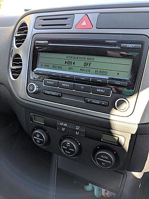

    I have an 09 tiguan steering wheel had phone button and star. Bluetooth is on the headunit. Appears not to be installed at factory.
    I've been reading I need to install 9w2 Bluetooth module is that correct.
    Just need to know which one I need to get. Attached photos of MFD , steering wheel headunit RCD 310? Under left hand seat has some weird thing with a clip on it.
    BlueTooth related questions (all BT questions go in this thread only)-idqvmus-jpgBlueTooth related questions (all BT questions go in this thread only)-oqrha0g-jpg
