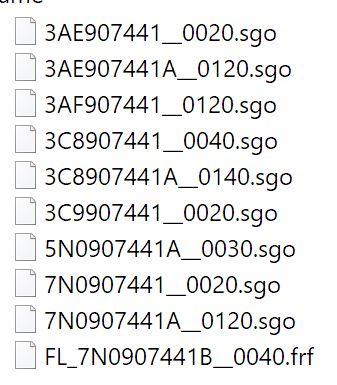

    The firmware looks to be tricky to find for the Amarok module, your best bet is to find a wrecker with the correct unit.
    Here is the list of units that can be cross-flashed.
    Amarok Highline Reverse Camera Control Module-firmwares-jpg
