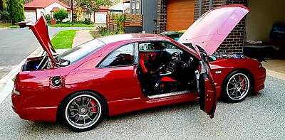

    Thanks Ben. I bought my 9/1994 model back in 1999. It had done approximately 42,000klm and has 67,000klm now. I used it as a daily for about 6 months.
    I ordered a Motec C125 for it yesterday and a set of Bosch 1650cc injectors. The current ID1050s are at their limit (mid 90s DC) and that's with base fuel pressure set at almost 58psi! The engine and supporting components are built for 1000hp territory, with the exception of the current gearbox. Boost will be increased from 29psi to 35ish.
