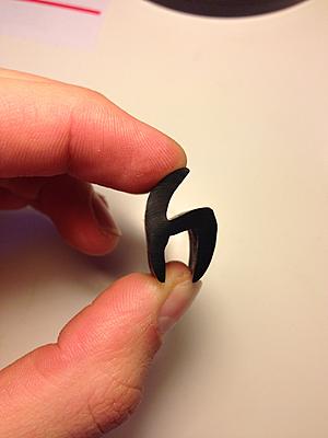

    This is the part I bought today. Only thing they had in the shop. Looks a bit thicker than mb1907953's post.
    Edit: I bought 2 metres, that's just a sample they gave me to check.
    Windscreen seal bit, where to get replaced?-img_4096-jpg
    Part is: 500 (internal store number?) Weather Strip WSP13/26 fetched me $14.95 a metre.
    The U area is where the glass sits in between right? And the lip goes over the plastic as seen in the photo below?
    Windscreen seal bit, where to get replaced?-img_4095-jpg
    Peeled a bit of the existing rubber off, yep, there's crap there. I assume I just need to unscrew the + circles to get to that area and I'll be good to clean it out?

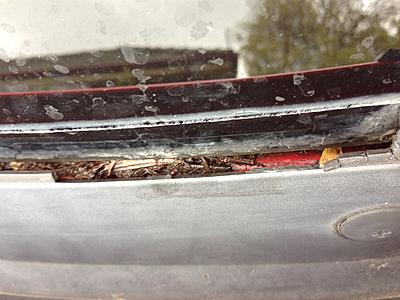

    Managed to remove one of the plastic trays.
    Windscreen seal bit, where to get replaced?-img_4098c-jpg
    woah, there's quite a bit there. Will clean it out properly but did this for now.
    Windscreen seal bit, where to get replaced?-img_4099c-jpg

    Make sure you get a vacuum in there and get it all out. Then inspect where the filter housing seals to the bottom of the chamber and make sure there arent any spots for the water to leak in.

    Why I've decided NOT to use the rubber seal.
    The seal was too thick and would not fit. Where the part of the U that sits under the glass (it does right?) there was enough seal there anyway so it was not needed.
    I've cleaned out all the area around the cabin air filter and the other side. Took out the leaf blower and got pretty much everything out of there. Cleaned over the rest with a damp cloth.
    What I did do instead and what I plan to do.
    Used Gumption to clean off the old rubber residue, then windexed the area.
    What needs to be done.
    The area that I talked about before about having enough seal in place needs to be done over to make sure it's properly sealed and even. I'll probably do this with some silicone, preferably black.
    Why I'm doing it this way.
    The two part tray catches the water and diverts it to the drainage holes anyway without the rubber. I just might need to clean out the leaves and what not that gets in there every now and then, shouldn't really be a problem. It looks better without the rubber. The windscreen disappears under the tray lip.
    This is the seal I was talking about with the windscreen. There isn't enough space for that rubber I bought to fit in here.
    Windscreen seal bit, where to get replaced?-img_4100-jpg
    As you can see I need to fill this gap up. The water will simply go over the lip and into the tray and drain away.
    Windscreen seal bit, where to get replaced?-img_4101-jpg
    Here it is cleaned up and put back together before I get around to sealing it up properly this week.
    Windscreen seal bit, where to get replaced?-img_4103-jpg
