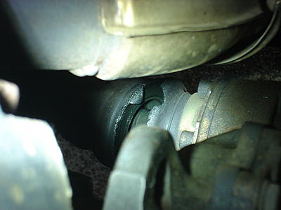

    What's this supposed to be and should I be worried? (looks to be just a sleeve on it but still want to be sure)

    Quote Originally Posted by stefcio007 View Post
    Torn CV joint boot......get it replaced as soon as possible or CV joint will be next on your shopping list.
