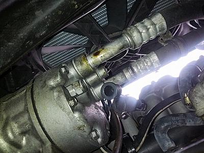

    Just wanted to confirm i did this without having to pull the front end off. Simply used a 1/4 drive with 2 short extensions. You can reach the top bolt either directly in front (fornt engine bay facing down) or from side access (Coil pack side) to do so. As always, space could be better but def enough room to get your arm in there and do the hob. a little fiddly but doable...
    Jun 2013
    Leichhardt, NSW
    226
    Thought i would post some pics. Not the greatest but you will get the idea. A little tight getting the top bolt off due to lack of arm space but an def be done. The bottom two are a piece of piss. When re installing though, nake sure you put both bottom bolts into the housing before lining up otherwise if you do one the right first, yu wont be able ot put the left in as the air con line is in the way..
