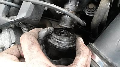

Split would cause vac leak and a sketchy idle.
Hello all
As a 2nd day owner of a VR6 and a backyard mechanic can you please tell me what this is.
I tracked this down whilst looking for vac leaks.
Would this cause a rough rev?
Would 8month old fuel contribute?
Thanks
What you have broken there (in the photos) is the PCV. It's only for emissions and doesn't effect the running of the car at all, at least for me it didn't, I drove with a broken one for a month or two. You'll just get oil around that area and might be able to smell it in the cabin.

It definitely could be effecting idle adding air after the MAF sensor.
First i would say fix the PCV, clean your MAF sensor with contact cleaner, clean out your throttle body and a new tank of petrol should get you going smooth.
If you want to go all out get a new fuel filter, plugs and a 02 sensor but the above should be more than enough.
For the PCV, follow this guide VWVortex.com - My breather PCV mod worked for me!
