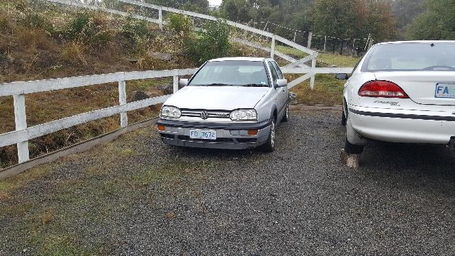

    Update: 21/03/2020
    Righto its been a while again and I can't figure out how to change the title of this thread but there has been a major change...
    Due to lack of 1.8t's going around in Tassie, I have somehow got myself a Vr6 even though they are rarer (thanks to Mick from up north of Tas), and if im being honest, im happier about this than a 1.8t. Good little car, downside is it is misfiring on cylinder one, checked the ignition coil and its still sparking so is either in the top of engine or a sensor is causing it to go spaz. I do have the fault codes for it so if anyone knows lots about the 12v, let me know and I can send them through.
    I'm keen to swap basically everything from the vr6 to the mk2. All suspension, brakes, fuel tank, whole wiring loom, and yea whatever else. I will even possibly try to do a dash swap as the vr6 is in very good condition compared to my mk2 one. I'm keen to get the wide track on it. Also I noticed the headlights look great on it and were purchased brand new in about 2010 (I think, i have the receipt) so if anyone wants, pm me, they were about 400ish...
    Todays progress was just doing a fair bit more looking, testing the engine and also got the front fender area in primer and will get hammertone tomorrow. Had to patch and little bit which had rusted out.
    I will take my current suspension off the mk2 and yea not sure what ill do with that. Keep it aside. Shame i put the effort into it/money.
    Anyways. Happy with the change of plans and keen to get the swap underway.
