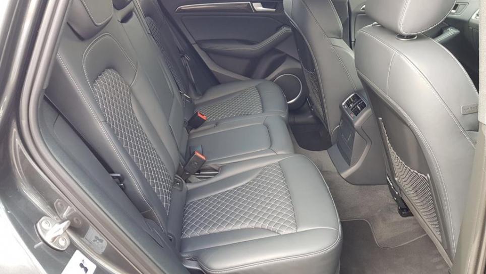

    In August 2018 I purchased a 2015 model Audi SQ5 for the wife to drive around and to be our primary family car. Needed something with some boot space and practical so we can fit our young child as well as large-ish dog etc. But apart from practicality, both the wife and I are car enthusiasts and love having powerful cars.
    This is the 230kw / 650nm model with the 3.0TDI V6 biturbo and 8 speed ZF auto. My brother who worked at the local Lexus dealership at the time sourced it for us, it has just turned 3 yrs old, 1 owner and had done 29,000km (I assume it was a lease car) and came from Melbourne.
    The car was very well spec'd, with only the black grill/window trim being the only desirable option not on the car - but it had the much more attractive quilted leather seats, 21" rims, Bang & Olufsen stereo (which pumps), carbon interior trim, heated seats, radar cruise and panoramic sunroof. The RRP on this car new with the options fitted would have been approx $113k, we paid $66k.
