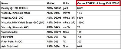

    Here is bit of a comparison between Castrol EDGE FST, Castrol EDGE Professional LongLife III (what VW fills at service and some overcharge if you buy from them) and Penrite Enviro+. These are suitable for DPF:
    Castrol EDGE FST 5W-30
    Castrol EDGE Professional LongLife III 5W-30
    Penrite Enviro+ 5W-30
    You will see that the two Castrol oils are identical in specs with Penrite Enviro+ having slightly more Ash but should not be an issue. Wait for specials and buy bulk. As long as they remained sealed, can be stored for long time. I paid $55 for Castrol EDGE FST 5W-30 and still have another left. Plus can fill up into dad's Golf (petrol engine) as well. They come from factory with Castrol oils and I prefer to stick to same brand in this case. You should have Castrol written on the oil cap on the engine.

    Cheers and thanks for taking the time for the informative reply!
    Yup bugger all differences between the specs of the castroland penrite, except the castrol can be had for dirt cheap on bathurst SCA annual sales, or at times they have a random blowout special on castrol edge (I got about 40L worth for $29.99 for each 5L edge 5W30 A3/B4 about 2 years ago!!)

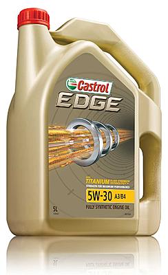

    Just be careful that A3 / B4 is not recommended for TDI engines especially DPF. That's different spec of oil. Lot cheaper than the FST for DPF diesel.

    In addition to above, Castrol EDGE A3/B4 has different classification:
    • Petrol : SL*, (SJ, SH and all superseded classifications):
    • Diesel : CF
    • ACEA A3/B4, High performance shear stable petrol/diesel engine oil
    • BMW Longlife-01
    • VW 502 00/ 505 00 (NOT 504/507 which is your longlife and VW recommended oil)
    • MB-Approval 229.3/ 229
    Did you get this bottle???
    Here are the specs for this oil:
    You will notice that the amount of Ash is almost twice as high as the other ones mentioned above, very bad for DPF and the actual oil itself as will collect more dirt (Ash / Sulphate) inside the engine. More sulphate, more smoke, more soot in your DPF (will clog-up faster). My advice is stay away from this oil in TDI engines.

    Yes I got the castrol edge DPF!
    I got sidetracked writing my post, I bought a heap on sale and had about 20L worth of the A3/B4 oil, I took it to SCA today and exchanged 10L for the edge DPF!
