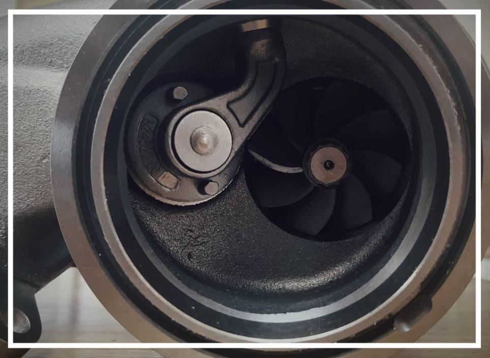

    After plenty of research I've decided to go with Littco L450. Mainly due to the upgraded thrust bearings. I was never going to go a Hybrid, a stock is38 was fine but due to the price this made the most sense. I probably won't push it to its full potential, I'll be happy if I safely achieve ~ 230kw at the wheels. Time to organise the little bits a pieces now.
    L450 HYBRID

    Hi,
    Wow, nice one. There must have been a few New Years resolutions to get a turbo swap!
    I’m not familiar with this brand, is it designed for 450 HP and what is the torque output ?
    Which tuner are you going with?
    Have you started collecting parts for the build?
    Interesting that Littco compressor blade design is a 7 + 7 design and TTE is 6 + 6.
    Which state are you from? I’ll add you to the first page, as I have been tracking IS38/turbo swaps for those that visit and contribute to the thread.
    It feels like that. I'm from QLD. 450hp + 420tq @ 1.7bar. Redline Tuning

    Yes if you’re going to buy an IS38 then at least this one has upgraded bearings in it plus the ability to make a little more on the stock IS38 doesn’t hurt Tiguan IS38 and Big turbo upgrades

    Hi,
