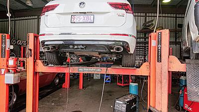

    Mk7r Muffler was fitted today.

    +1 to Melbourne_Tiggy's comnments want to know how easy/hard and whether additional hangars were required. Also interested to find out where they connected into stock exhaust and how easy/hard it would be to put the old system back on.
    It looks the goods. Any chance of a close-up of the tips and exhaust cut-out to see how much clearance you have (and whether you had to trim the cutout to make it fit).
    I'm considering going down this path if it's a reasonably easy thing to reverse.
    And of course sound clips once the valves are open!!

    Hey that looks pretty good! How does it sound? Did it bolt on nicely to existing exhaust hangers or was there a lot of welding required ?

    I've tried to include as many images that show everything to hopefully answer anyone's questions. Clearance is really good, only notifications to the stock Mk7R muffler is the flanged connection and extension of the tips. Stock hanger positions on car and muffler. With the rear wiring, you can see that I've just clipped it higher. Unfortunately the stock clip position for the wiring is on the Exhuast Trim bracket.

    Quite enjoying it to be honest, much quieter in the cabin and no drone. Still to remove the centre muffler but going to wait until turbo is fitted and tuned before making that move.
    I had a rattle at idle but that was from when I removed the valve actuator and didn't fit it back properly. It wasn't in the grove for the valve, so it was able to move and was tapping closed. Easy fix.
