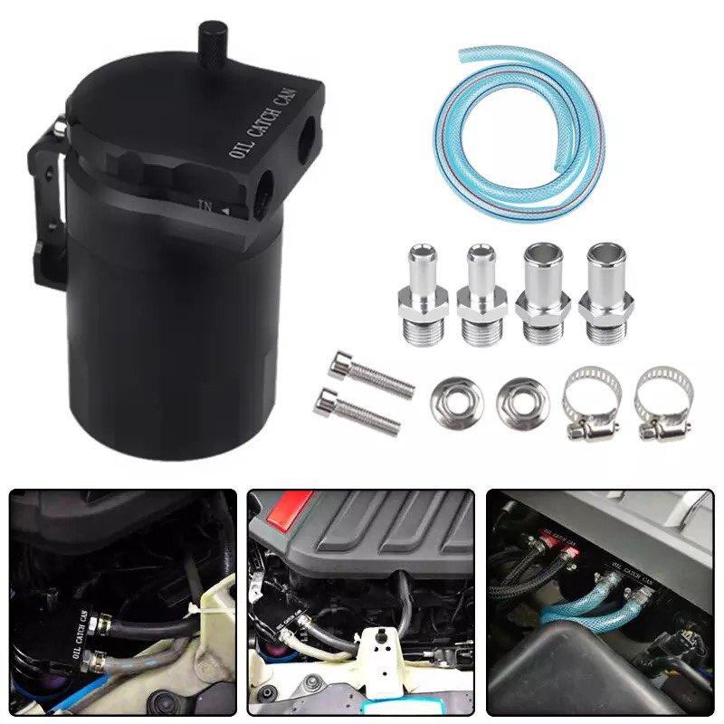

    Feb 2019
    South Africa
    37
    Oil residue in intake pipes
    Do this is what I bought off AliExpress. Going to build my own setup. May add the Afrika plate to the setup. Else just going to connect the Oem pcv outlet pipe to these pipes. Mount can on front right side. And see how it works. Sum total so far. US$55.
    Loads of options on AliExpress. Get that this was the best for the prices. Got black obviously.
    Got the nylon as braided hose and -10AN fittings to replace the cheap garden hose piping.
