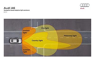

    Not sure if this has been covered previously, it's in regards to the highway/"country light" setting with DLA (see Audi's teminlogy).
    Previously with DLA activated, I had the issue of the RHS lights always being on low beam at speeds above 80kmph, that is the "country light" pattern. Great if you are on the Hume, not so great when on a two lane B or C road in the country.
    I've played with Module 4B as described in instructions in this thread and disabled Byte 10, Bit # for "Highway_light" via long coding. Counter-intuitively, I've now got the "motorway" beam pattern for all scenarios with the usual adaptive beam forming for masking traffic ahead or oncoming cars. Less useful on the Hume/split carriage-ways, but great for back roads.
    my long coding for this mod in Module 4B is now "0000 00 05 01 00 08 56 07 10 57 05 0A" - this was implemented and tested in a MY18 SWB R-line with "mid" lights. No faults recorded
    I did the whole head unit reboot, factory reset light settings and "basic setting" routine after making the change.
    Hope that helps people if they find they have dipped RHS beams at speeds above 80kmph.
    Ta

    Nice find and thanks for sharing.
    With DLA activated on my car, if there's no traffic in front and the speed is above the DLA activation speed, I get high beam on both lights. It only deviates according to oncoming traffic, traffic in front or it detecting street lights.
