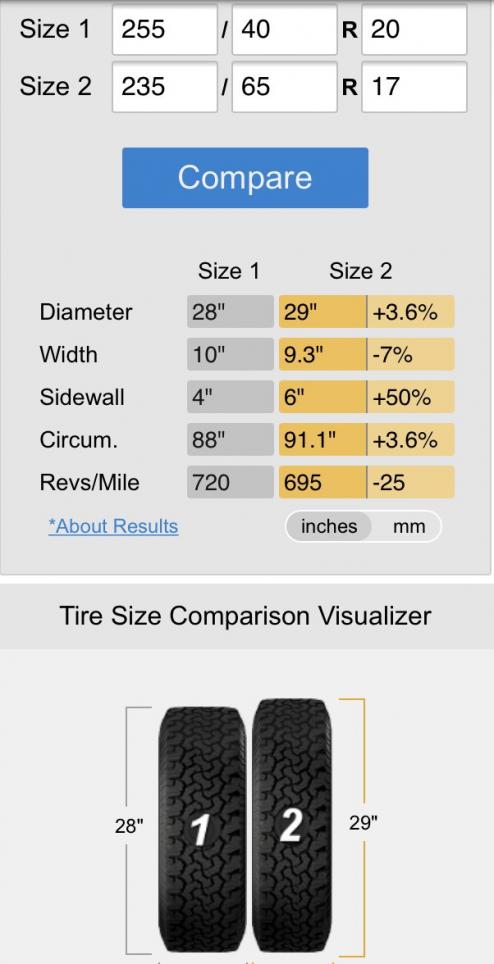

    Hey, thanks for the input. I'm not familiar with those measurements you noted sorry but basically the stock wheels currently on the car are 255/40 R20. So I think as long as the brake clearance is fine, I should be able to fit ie. a genuine 18" rim from VW and fit a 235/55 R18 on it or so. Do you think 17" would be better? I had the Yoko GO15s on my Forester before and yeah, great tyre!

    Heres the truth You can only go 15mm larger diameter or 26mm smaller.
    What happens if you do
    Larger your speedo will read slower than it did before.
    You should check it now against a GPS to see what it reads at 100kph and will possibley read as high as 107.
    So a slightly large diameter will bring it closer to correct.
    Gearing will be slightly higher so slower off the mark Braking not quite so good
    Smaller diameter Speedo will be wildly out and show a much faster false speed
    Braking will be better and will be faster off the mark
    You can check it here as its a really good comparator Can alter sizes and also offset etc.
    Will give speedo differences as well
