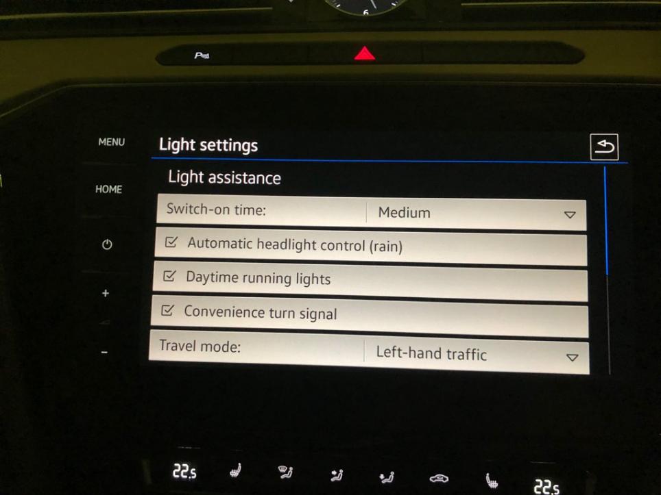

    This is what it looks like on my MY18 Alltrack Wolfsburg

    i have it now coming up and configured to 'late'...still think the lights come on too early.....thanks everyone for response
