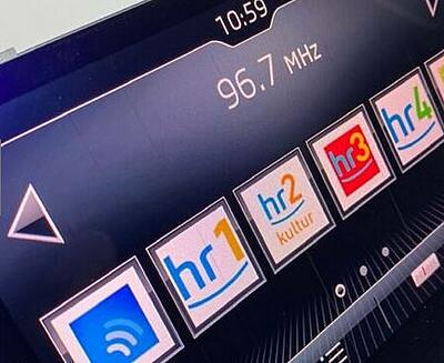

    Does this media screen look alright?
    I can see some lines in the image and I'm assuming that they shouldn't be there
    Does this media screen look alright?-lines3-jpg
    Does this media screen look alright?-lines2-jpg
    or
    Does this media screen look alright?-lines-jpg
    The reason I am asking is because I've been offered it at a really cheap prize.

    Definitely doesn't look right to me...
    2023 MY22 Arteon R-Line Shooting Brake
    2016 MY17 Golf 92TSI Comfortline Wagon
    Previous - 2019 MY18 VW Passat Alltrack Wolfsburg Edition
    4,088
    Very common failure.
    If it's under warranty get it replaced.
    Harware revision 51 and above on the screens are better, but still not immune to this issue.
