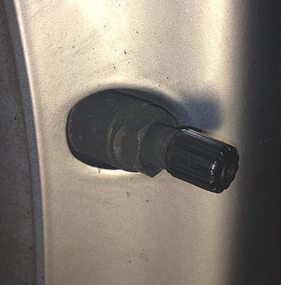

    I'm surprised by this. I've investigated this before (not long after I got the car and the light came on), and I'm pretty convinced this '08 tdi doesn't have direct TPMS. It certainly doesn't appear to have special valves. They just look like standard valves.
    Hmmmm

    Quote Originally Posted by WestcoastPete View Post
    Hmmmm
    Unless you look inside the tyre you can't tell the difference.
    The sensor is behind the stem. (Stem is part of it but looks no different externally to a regular valve stem)
