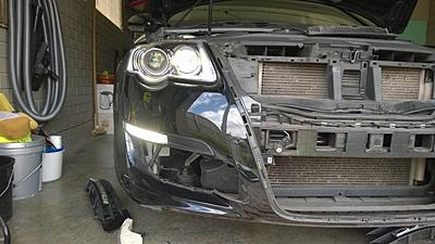

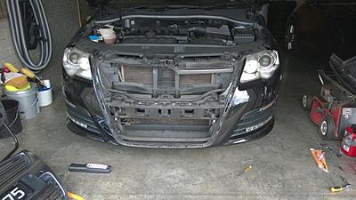

    Well I got me an updated DRL set that replaces the blinkers and looks OEM. Found these online and wished that they had been around about six months ago when I did an install for my first DRL's that I bought (can be seen in the first pic). Installation was relatively easy. I decided that I would try and remove the grill. Was a little nerve racking at first but in the end it was quite easy. Just have to remember to pop out the two parking sensors rather than disconnecting them. It was a little tight but once you have them out it is all smooth sailing from there. For those trying for the first time, the grill inserts on the two sides might be a little tricky but they have two screws and then they are just clipped in. The blinker has one screw at the front underneath. The only wiring needed for this is a switched power from an ignition style fuse, and a lead from the positive side of the parkers so that they dim when the headlights come on. Apart from that, they are all simply just plug and go. Really easy. Zip ties are you friend here too! Here are some pics. No comments about how dirty she is either. She's getting a bath over the weekend!!
    Ask any questions if you have any.

    To intall these DRLs, there is no need to remove grill or bumper, unless you want to take the opportunity to do other stuff.

    Would be pretty fiddly I'd imagine installing the cabling with bumper on?

    Yeah, there's no need to remove the bumper. Just the grill. It is relatively easy. I did actually have my first DRL wiring running through the top of the grill just in front of the radiator but the wiring loom that comes with this set comes in a plastic sheath so i wanted to keep that on so that it protected the wiring a little. All in all, really easy mod. Now that the blinkers are LED's, the only filament bulb i have in the car is over the rear cargo area as im waiting on the LED festoon bulb to come. Once that is here, LEd's all the way baby!!
