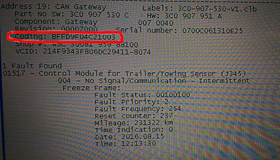

    Hi kamold, I found the last VCDS log and the 19 gateway coding sequence. Cheers
    Recoding new CANBUS replacement module-imag2675-g19-copy-jpg
