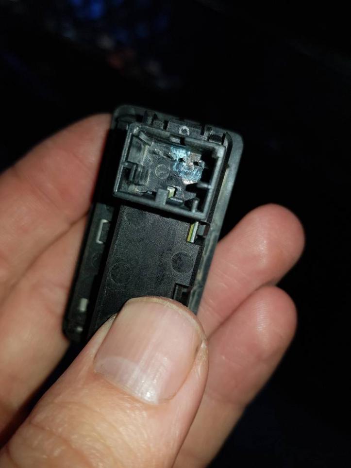

    Hopefully someone can help. Yesterday the powered tailgate on my R36 wagon decided it was no longer going to open fully. Only opens about 1/4 of the way.
    Did a scan this afternoon and got an "implausible signal" error from the rear switch.
    I took the switch out and it looks like there is some corrosion on the inside of the connector plug and inside the switch.
    I removed the switch, cleared the fault and rescanned. The error is gone now but the door still won't open.
    Any advice? Hopefully I don't have to replace any door motors!?!?

    Manually open it by lifting it up then hold down the button to close it for 3seconds till the indicators flash then the new height should be stored good feature if you're garage roof isn't as high as the tailgate opens.
    Jun 2015
    Willy, Victoria
    198
    Quote Originally Posted by bushnut View Post
    Thanks mate. That did the trick.
