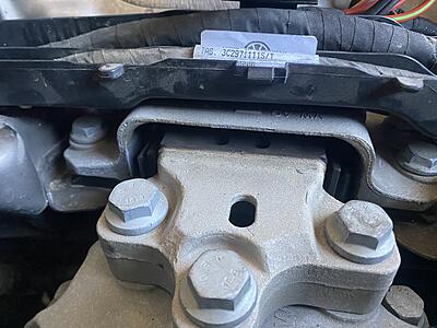

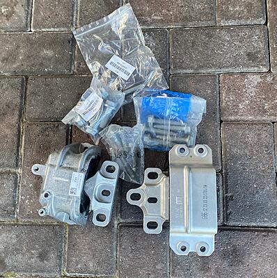

    The mounts are pretty easy to swap. I did not notice a vibration with mine before replacing them, but it seems much smoother now.
    I replaced mine as they had pretty much collapsed.
    R36 judder/vibration idle issue - cannot resolve-img_0073-jpg
    R36 judder/vibration idle issue - cannot resolve-img_0070-jpg
    R36 judder/vibration idle issue - cannot resolve-img_0074-jpg
    MY12 Passat FSI Highline | 3.6L VR6 | Cashmere Brown | Driver Assistance Package | Dynaudio | Discover Media | TPMS Direct | Side Assist | Adaptive Cruise | 3D colour cluster | More coming soon
    Genuine VCDS HEX-NET and VCP Pro
    4,088
    My trans mount was...well...totally flaccid.
    No harm in replacing if it hasn't been done before.
