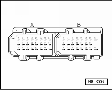

    I had to cut, swap and then rejoin pins 16 and 20 from the connector block A for the climatronics panel and it now remembers its settings

    Shout out to Dean from VW Central who figured out what I needed to do with the pin swap to get the panel remembering its settings.
