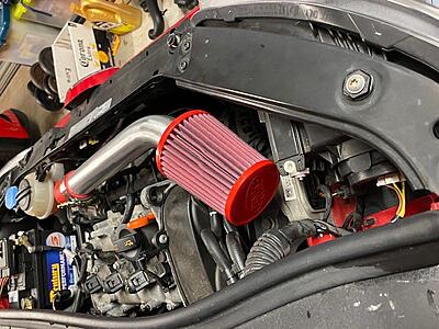

    So made and fitted an intake to the Up! this weekend.
    I studied the only 2 commercially available intakes for NA Up!s that I could find and figured I could do it far cheaper myself.
    Up / Citigo / Mii 1.0L Short Ram air intake system - Volkswagen 234 Euro!!
    So, stock intake layout
    Sharkie's Up! Project-up-stock-intake-jpg
    Custom intake test fitted after fabrication
    Sharkie's Up! Project-up-cai1-jpg
    End result (some awesome growling now at revs)
    Sharkie's Up! Project-up-cai2-jpg
    Sharkie's Up! Project-up-cai3-jpg
