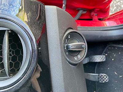

    Fitted Auto headlight switch to the Up! this weekend.
    Sharkie's Up! Project-up-auto-4-jpg
    Sharkie's Up! Project-up-auto-5-jpg
