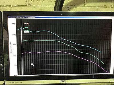

    Here you go, all totally stock hardware. This is on our dyno which is fairly cruel
    Stock S3 Vs JB1 V's our stock hardware custom tune (12.1@112~114 ish tune that is)
    The JB4 is miles ahead of the other option mentioned just don't.
    Power, compared to stock you can see with the JB its a really good gain everywhere - its just works. You can also see the AFR's here too sitting at 12.4~12.5 which is fine (and you can also see mine which is a touch too rich for peak power but fixed now )
    You can push these interceptors harder too but beyond this point the AFRs skyrocket into the 13's so its a bit risky and yet I've seen a few cars that run like that all day but for how long ?. Same goes for the ABT unit too.
    The JB device will eventually have a lambda option to add additional fuel.
    Oh blatant plug for me the - tune is another jump up again especially down low
    I don't sell the JB FWIW there is simply no margin in it for me but yep it works
    Racechipone vs JB 1 plug and plays-13147513_1733408653573035_4777650176269896464_o-jpg
    Torque
