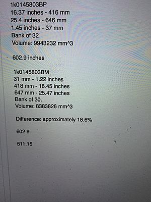

    What's the part number for your stock intercooler?
    Here are my measurements for my stock versus s3 intercooler.
    Core for s3 intercooler is 37 mm.
    The great big MK6 Golf 118TSI tuning thread-imageuploadedbytapatalk1455962830-009392-jpg
