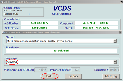

    Enabling Driving School Mode - VCDS tweak
    I rely on the digital Speedo on my Golf a-lot when driving. But, when I use the MFD for other purposes (like navigation, say), the digital speed is lost. Well here is an interesting VCDS tweak that reinstates the digital Speedo in these instances (albeit the replacement Speedo is displayed on the discover media screen rather than on the MFD). Even if you have no interest in this function at the moment, I reckon that it's a good facility to have enabled (in the background) in case the need arises later. I've implemented this tweak on my car and I can vouch that it works. Acknowledgement to the stemei.de site for the original material.
    Edit: Before proceeding, I should make it clear that once the tweak is implemented, the Driving-School mode screen will become the default page whenever the "CAR" button is pressed (thanks Jonoz), This notwithstanding, the tweak does NOT affect access to any other pages or screens. (simply press the <, or > symbols on the screen, or press the "view" panel at the bottom LHS)
    Enable DRIVING SCHOOL MODE - mkVII Golf
    1. Select 5F- Information Electr.
    2. Select 10- Adaptation
    3. From the pull down channel list. select (11)- Vehicle function list CAN-Driving_school (it's about 40% down the channel list)
    4 In the New value box, select Available option. Click Do It! tab. Click Add to log to record a copy of the change report.
    5. Click Yes in the VCDS:Re-Code Invalid dialogue box
    6 From the pull down channel list. select (171)- Vehicle menu operation-menu_ display_ driving_ school (it's about 75% down the channel list)
    7. In the New value box, select activated option. Click Do It! tab. Click Add to log to record a copy of the change report.
    8. From the pull down channel list. select (173)- Vehicle menu operation-menu _display _driving _school _over _threshold _high (it's about 75% down the channel list)
    9. In the New value box, select activated option. Click Do It! tab. Click Add to log to record a copy of the change report.
    10. Click Go Back and exit from the VCDS software.
