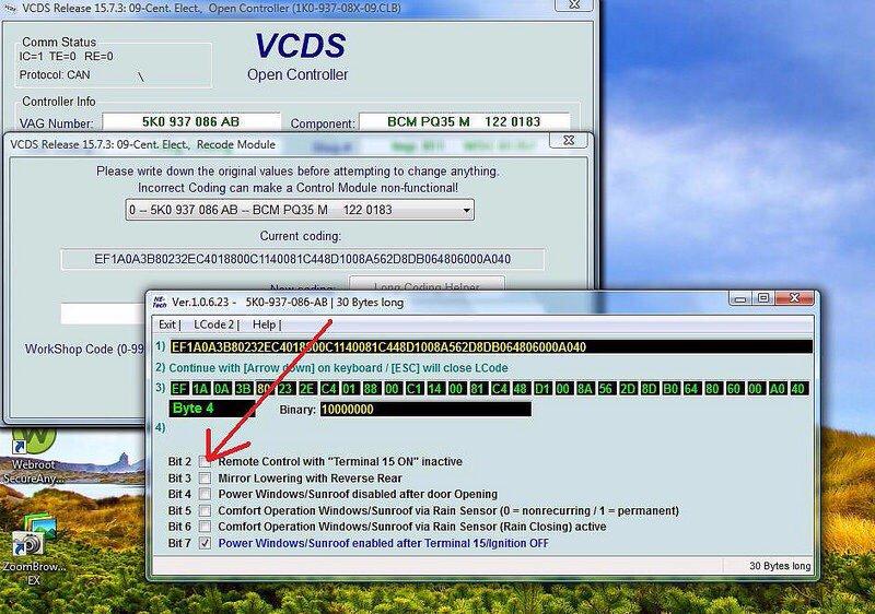

    Just found this picture from another thread that shows a completely different byte for changing the auto rain close. Is this from a different or older vehicle or is the reason I can't get mine to work because I've not checked the boxes? I've done byte 00 bit 1 and 2 just like the instructions.
    2015 Golf R. Lapiz Blue.
  7. #967
    1,838
    ^^^ Reedy : I do admire your persistence in trying to get the auto Rainclose tweak to work!
    Unfortunately, the master control module in your screen shot (the BCM 5K0-937-086) was installed in non - MQB platform vehicles. The mk7 was the first Golf to use this platform and a number of fundamental changes were made to the control modules in this car to cater for new innovations and basic changes in the network structure of the various CAN buses.
    This is a long way of saying that mk7s don't have the screen shot in your post - alas, so you can't access that particular long-coding-helper screen on your car
