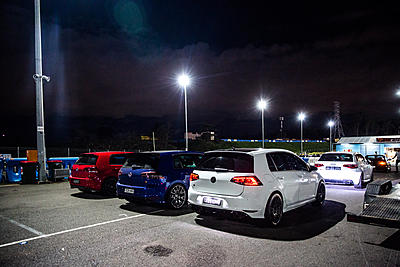

    my Brake/Indicator LED at the edge of my outter tails doesn't seem to like turning on (See Image)
    any ideas on how to turn them on?
    fonsii: Nice picture, but I don't understand the question - alas! To which section of the tail-light fitting on the picture below are you referring (note that the tails have an un-lit border surrounding the LED clusters)?

    thanks for the reply! see image^
    so upon braking the red led at the indicator does light up, but otherwise it doesn't.
    Attached Thumbnails Attached Thumbnails VCDS (VAG-COM) codes and programmable options for Golf Mk7-exodcgr-jpg   VCDS (VAG-COM) codes and programmable options for Golf Mk7-untitled-1-jpg
