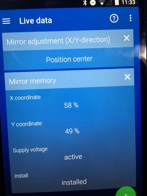

    It's relatively easy to find-out if your passenger-side door control module is fitted with a memory module to facilitate reverse dip as follows:
    1. Select the control module at address hex52 and then select Advance Measurement.
    2. Click the boxes for the variables shown on the right-side of the screenshot below and if your car is fitted with a memory module, you should see the values in the left-side of the screenshot below. (Note: the "X" and "Y" coordinates may differ - but the values can't be 255 (which is HexFF) and 046 and 047 MUST be as shown)
    If your car isn't fitted with a memory module, the results of the Advanced measurement should be as below (which is the result for the driver's side door control module on my car)
