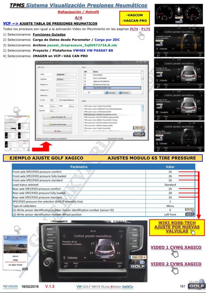

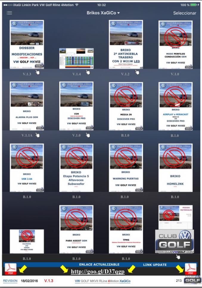

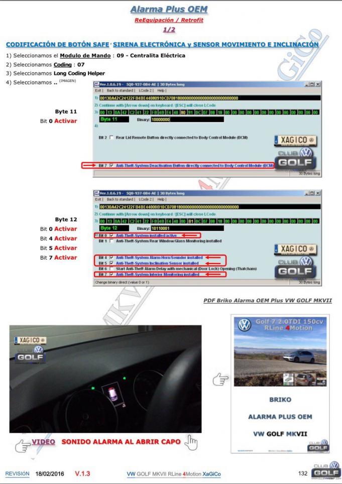

    VCDS (VAG-COM) codes and programmable options for Golf Mk7
    UPDATE TUTORIAL MODS VW GOLF MKVII v.1.3
    In Spanish!!
    News v.1.3 :
    Link Updated - > PDF DOSSIERS MODIFICACIONES PARA VW GOLF MKVII
    https://goo.gl/D37qgp
    Versión v.1.3 18-02-2016
    Size + 111MB
    Numbers of pages 216

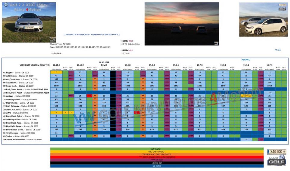

    Controller Channel Map (Mapas de Adaptación) y Auto-Scan en varias versiones de Vag-Com en el VW GOLF's MKVII de @XaGiCo y @Algagu
    New Data 10 , 65 y VAGCOM 15.7.3
    Link Updated
    NeXT Toturial Park Assist Retrofit sin e Park Pilot ....
    Link Club VW Golf España -> VCDS/VCP MKVII
    http://www.clubvwgolf.com/foro/showt...=1#post3189838
    Enjoy It!!VCDS (VAG-COM) codes and programmable options for Golf Mk7VCDS (VAG-COM) codes and programmable options for Golf Mk7VCDS (VAG-COM) codes and programmable options for Golf Mk7
    Good Day / Night!!
    Regards!!
