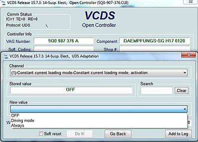

    monkeysrus: Hmm....... I really don't know the answer to your question as I have never played with this control module.
    I'm guessing, but I suspect that nothing will change because the adaptation channel 1)-Constant current loading mode-Constant current loading mode; activation is set to off . I suspect that none of the "constant current" channels will show anything but zero as long as this channel is not active. I also have no idea what forcing a constant current value into the individual suspension tubes will do - please provide feedback if you try different values (I'm interested from an a academic perspective)
    Perhaps a better way to investigate (before changing adaption channels) is to use the "Advanced Measurement" facility in VCDS first. I'm not sure what parameters are available in this control module - but might be prudent to "rummage-around" in this part of VCDS before modifying adaptation channel values
    PS: As I said, I hope that you don't need a security code!
    Had a little look around. You are correct nothing seems to change when i change the modes with the car running and re read the module.
    The options under the loading mode are as follows:
    VCDS (VAG-COM) codes and programmable options for Golf Mk7-dcc-jpg
    Driving mode i assume relates to the switch-able mode in the car. How do i get the the values related to the subset of information??? Comfort, Normal Race etc???? Why would it be off and not driving mode??????
    Ill rummage around further!
