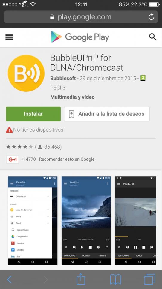

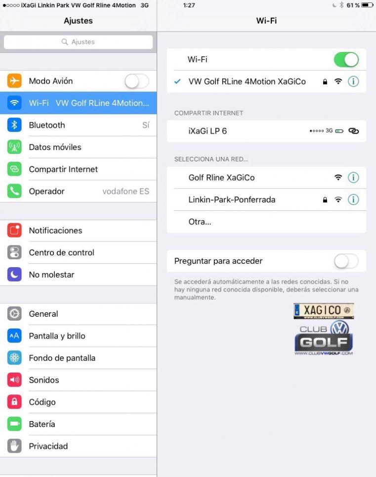

    Hi!!
    Yeah!!!
    Very Very Thanks @Chillout
    Enabled WLAN access point
    But it leaves an error!
    Example App DNL UPnP Apple:
    Example App DNL UPnP Android:
    Regards and Good Day!
