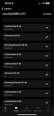

    Hi Don,
    The light of the
    Brake is on the outside, that must work as original when I press the brake, I would just like to remove the two side lines that I highlighted in green (see attached photo). As for the legal part, the external light I can turn off the position lights without problems, you have no responsibility for this. Now I am attaching the data of the control unit you requested.
    Postscriptum
    (I see that you are very informed, where can I find this information on how to read the data of the “leuchte”? I see a lot of numbers and a lot of addresses and some wording in German)
    Thank youVCDS (VAG-COM) codes and programmable options for Golf Mk7-img_6116-jpg
    VCDS (VAG-COM) codes and programmable options for Golf Mk7-img_6117-jpg
    VCDS (VAG-COM) codes and programmable options for Golf Mk7-img_6118-jpg
    VCDS (VAG-COM) codes and programmable options for Golf Mk7-img_6119-jpg
    VCDS (VAG-COM) codes and programmable options for Golf Mk7-img_6120-jpg
    VCDS (VAG-COM) codes and programmable options for Golf Mk7-img_6121-jpg
    VCDS (VAG-COM) codes and programmable options for Golf Mk7-img_6122-jpg
    Inviato dal mio iPhone utilizzando Tapatalk Pro

    Ok I confirm leutche 18 and 19 are external, while the internal ones are 23 and 24 and I confirm the operation of those
    External as you listed.

    OK - try this (read the note after my coding list - please):
    Leuchte20BR LA71 (left-side inner tail-light)
    Lasttyp 20 > 34 - LED Bremsleuchten
    Lampendefektbitposition 20 > 09
    Fehlerort mittleres Byte DTC-DFCC 20 > 2B
    Lichtfunktion A 20 > Bremslicht
    Lichtfunktion B 20 > nicht aktiv
    Dimmwert AB 20 > 100
    Lichtansteuerung HD AB 20 > Always
    Lichtfunktion C 20 > Standlicht allgemein (Schlusslicht; Positionslicht; Begrenzungslicht)
    Lichtfunktion D 20 > nicht aktiv
    Dimmwert CD 20 > 28
    Dimming Direction CD 20 > maximize
    Lichtfunktion E 20 > Coming Home oder Leaving Home aktiv
    Lichtfunktion F 20 > Parklicht rechts
    Dimmwert EF 20 > 100
    Dimming Direction EF 20 > maximize
    Lichtfunktion G 20 > Tuerausstiegslicht links
    Lichtfunktion H 20 > nicht aktiv
    Dimmwert GH 20 > 100
    Dimming Direction GH 20 > maximize
    Leuchte21BR RC8 (right-side inner tail-light)
    Lasttyp 21 > 34 - LED Bremsleuchten
    Lampendefektbitposition 21 > 19
    Fehlerort mittleres Byte DTC-DFCC 21 > 2D
    Lichtfunktion A 21 > Bremslicht
    Lichtfunktion B 21 > nicht aktiv
    Dimmwert AB 21 > 100
    Lichtansteuerung HD AB 21 > Always
    Lichtfunktion C 21 > Standlicht allgemein (Schlusslicht; Positionslicht; Begrenzungslicht)
    Lichtfunktion D 21 > nicht aktiv
    Dimmwert CD 21 > 28
    Dimming Direction CD 21 > maximize
    Lichtfunktion E 21 > Coming Home oder Leaving Home aktiv
    Lichtfunktion F 21 > Parklicht rechts
    Dimmwert EF 21 > 100
    Dimming Direction EF 21 > maximize
    Lichtfunktion G 21 > Tuerausstiegslicht rechts
    Lichtfunktion H 21 > nicht aktiv
    Dimmwert GH 21 > 100
    Dimming Direction GH 21 > maximize
    Leuchte23SL HLC10 (left-side outer tail-light)
    Lasttyp 23 > not active
    Leuchte24SL HRA65 (right-side outer tail-light)
    Lasttyp 24 > not active
    Note: I've highlighted Dimmwert CD above. The value in this channel determines the illumination level of the lamps in Parking Light mode - not sure if Italians call these "position lights"? Dimmwert CD = 28 is a guess!!
    I suggest that you experiment with this value for the particular LEDs in your tail-light fittings (the efficiency of photon production at various dimming levels can vary substantially across different LEDs). Find an acceptable Dimmwert CD number that yields sufficiently high illumination for the Parking light mode while also being dim enough so that cars at the rear can distinguish when the driver presses the Brake pedal. Of course, the best way to make this judgement is by experimenting during night-time conditions
    PS: I've tested my suggestions above on my test-bench - works OK!!

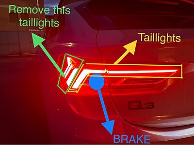

  6. #1916
    I tried your configuration, so the external part turns off completely, (the one in the black circle) I would have liked to turn off only the two external LED lines and leave the third remains on the brake light at intensity 28
    I leave you 2 photos to make you understand, I would like as in the yellow circle for the position lights (at this point I believe that the external position lights turn on or off all together without the possibility of dissecting them)
  7. #1917
    1,826
    @samusi: OK - that's why I asked:
    Please confirm that the outer tail-lights (the lamps that you identify as "Remove this Taillights" in your picture) operate as the following light-functions:
    1. Parking Light (position light)
    2. Coming/Leaving home
    3. Single Side Parking Light
    4. Door Exit Light
    Is this correct - do these 4 x Light functions currently operate on outer tail-lights?
    So, here's the thing about Leuchte-sets on MQB platform cars (like your Golf) - each individual Leuchte-set controls a single pin on the module that OBD11 calls central electrics. This means that a single Leuchte-set controls the single wire that is connected to this module pin at one-end - and at the other-end, is terminated on the single pin on the tail-light connector.
    Apparently on this car, that tail-light pin is internally connected to the 2 x lamps on the outer fitting (as you show).
    Bottom line - To get your wants, you need to open the outer tail-light fittings and physically remove the link to the unwanted lamps!!! This aspect of your question is NOT a coding matter
