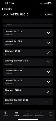

    Good evening everyone, I was “playing” with obd11 in the control unit 09 in the light channels, specifically the “leuchte23” and “leuchte24” which are the taillights and I was wondering if you could disable the LEDs in the red circle and leave only those in the green circle on, is there any experts on this that can help me?
    Thank you for your helpVCDS (VAG-COM) codes and programmable options for Golf Mk7-img_6105-jpg

    @samusi1:Hi
    So, an Audi Q3 question posed on a Golf mk7 forum?
    Very little information provided to give an accurate response - like:
    • You don't say which country - but from the message "Inviato dal mio iPhone utilizzando Tapatalk Pro" this could be an Italian car (maybe?).
    • What build year is this car?
    • I assume that the tail-lights on this car have incandescent lamps (maybe?)
    Depending on the build year, this Audi might share the same DNA as the cars on this part of the forum (i.e. MQB platform). However, the factory assignments of the Leuchte-sets will be different - so again more information needed.
    • Please provide screenshots of Leuchte 23 and Leuchte 24 - to be clear, I need to see ALL 19 x adaptation channels in each Leuchte-set
    • Will this car remain road-legal in your country if the outer tail-lights are disabled and the outer-light functions transferred to the inner lights?
    • Have you made a back-up of the 09 central electrics module on this car?
  10. #1910
    @samusi1:Hi
    Hi Don,
    First of all thanks for the answer, I know it’s a post for mk7 but you are very knowledgeable and I tried to ask here, sorry. The data you requested from me is as follows:
    Audi Q3 F3 sportback my 23 Italian with MIBIII
    LED taillights with an example in the photo I posted earlier
    VCDS (VAG-COM) codes and programmable options for Golf Mk7-img_6107-jpg
    VCDS (VAG-COM) codes and programmable options for Golf Mk7-img_6108-jpg
    VCDS (VAG-COM) codes and programmable options for Golf Mk7-img_6109-jpg
    VCDS (VAG-COM) codes and programmable options for Golf Mk7-img_6110-jpg
