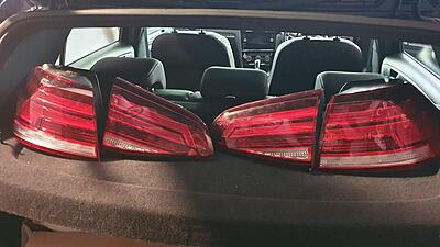

    My car has tail lights that look like this:
    VCDS (VAG-COM) codes and programmable options for Golf Mk7-170901_volkswagen_golf_gti_04-jpg
    They are LED clusters with no inner indicator lights - only outers.
    The wiring kit included did not include connectors - only pins. The instructions have steps for popping open each of the existing connectors in the rear of the car and moving existing pins (to repurpose as you mentioned) as well as insert the new pins.
    There do not appear to be any spare wires in the existing connections to the BCM. I do have the appropriate tools to pop the pins out (I wired up a Helix audio upgrade last year).
    I've been told there is a method for connecting the lights that avoids needing to run the new wire to the BCM and adds some additional wiring between the inner and outer clusters, but I'm not sure how that would work. Correct me if I'm wrong, but I'm guessing this would rely on drawing power from the outer indicators and the inners presumably already have a circuit to delay the blink slightly and give the "dynamic" effect.
    I suspect I am best following the instructions (scanned in) instead of overthinking it.

    Hi Don. I haven't made any wiring changes yet. I have simply connected up the new lights with the existing connectors. Lights appear to work (except the inner indicators - and I didn't check the fog light). There are no error codes.
    I will take photos tomorrow of the old and new clusters and verify both the location and type of each lamp, and functionality. Thanks!
    But I'm not sure which lamps are joined given that you say that the tail-lights fittings have "no inner indicator lights".
    What I mean is:
    1. The original factory clusters do not have inner indicators
    2. The new clusters DO have inner indicators, but they do not currently do anything

    Arrhhh........ that's different to my previous understanding - the new 4 x wire harness makes much better-er sense now!!
    My previous confusion about the purpose of the Blue/White wires now evaporates - clearly these wires join the inner/outer turn-signal lamps together on each car side (because the factory wire loom for the original fittings doesn't have a turn-signal wire for each of the inner fittings).
    And the new revelation explains why the yellow wire is also connected to the inner fittings - because a T15 Voltage is also needed to supply power for the LED chaser circuits that operate the inner dynamic turn-signal function.

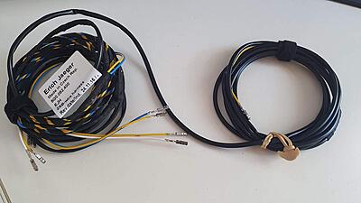

    Here is a picture of the new harness that was included:
    VCDS (VAG-COM) codes and programmable options for Golf Mk7-20230206_101551-jpg
    Here is the description on the box:
    VCDS (VAG-COM) codes and programmable options for Golf Mk7-20230206_115106-jpg

    So, let's try to get the dynamic turn-signal lamps operational first. As per the instructions - the yellow wire was terminated onto pin #6, Socket C of the module that OBD11 calls central electrics. The Leuchte-set that controls this pin is Leuchte27NSL RC6. Because there was no wire on this pin prior to this project, this Leuchte-set would have been factory disabled (I think)
    If my guess is correct about the yellow wire being the power supply for the LED chaser circuits - the above Leuchte-set will need to be enabled AND the appropriate Leuchte-command for T15 Volts added ("T15" = switched battery rail volts ONLY when ignition is turned-ON)
