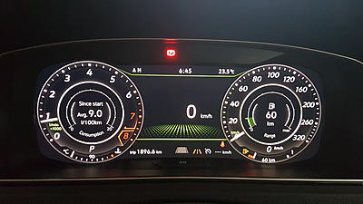

    does the ambient light in the footwell change colour or are the factory leds not rgb? can you post a picture if they do.
  6. #1646
    Feb 2018
    11
    The LED in the footwell/door are not RGB so you can't change the colour to correspond the console/head unit (confirmed by VW mechanic). I'm keen to know how/where to purchase the required RGB LED (or whether you need a whole new door card which won't be cheap) so that they can be interchangeable with the rest. Thanks for the codes they worked a treat and look good. My favourite is electric lime. I used the following website to come up with my own 10 colour schemes...

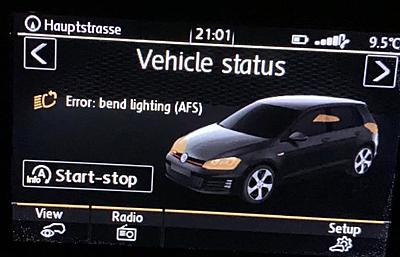

    rror: Adaptive Front Lighting (AFS)
    Good evening!
    I have a 2013 GTI Golf, and I decided to change the AFS light because I had changed some lights and... then I decided to put a LED!But... there's a problem!
    I've changed the AFS H7 to an LED! and the error appears because of the voltage indications, I think!
    There is a way using Vagcom/VCDS to solve the error of AFS?
    Some one to help?
    Best regards

    david: hi - can you post-up the actual error message? Even better, perhaps a copy of the autoscan results for the car so we can see how you coded the BCM.
  10. #1650
    Apr 2019
    Switzerland
    4
    Hi @DV52 this is the error message that the VCDS gives to me...
    VCDS (VAG-COM) codes and programmable options for Golf Mk7-afs-error-msg-jpgVCDS (VAG-COM) codes and programmable options for Golf Mk7-car-error-jpg
    Thank you so much! Hope that some one can help me!
    Best regards
    David Gonçalves
