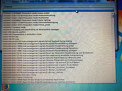

    I used to run laps around the old Mk5 Golf set up, but I can't seem to understand the Mk7 layout.
    Everyone seems to be talking about the channels being really easy to navigate to but on my Golf, it's all in German and with very long, convoluted titles. Am I doing something wrong?
    Thanks

    ^^^ Maca: you aren't doing anything wrong - the names for individual adaptation channels on VW control modules can be entirely English, entirely German and a mix of both! It really all depends on which module is in the car and what version firmware in installed in the module.
    Just as starting advice (seeing that you are new to VCDS), if you look carefully at the names, you will see a pattern in the naming convention that the Ross-Tech reports. Here's an example from your picture
    IDE02269-MAS04382-Acknowledgement signals-Optical feedback during locking
    Notice the structure of the naming convention: it is like the naming convention of a relational database in that there is often (but not always) a "Parent" part and a "Child" part. So in the channel above, the relational database elements look like this :
    Parent Tag Number - Child Tag number- Parent descriptor - Child descriptor
    The elements of the naming convention are separated by "-". If you look at the remaining adaptation channels in your picture related to "Acknowledgement signals", you will see that they ALL have the same Parent Tag number (i.e. IDE02269)
    So, if you recognize that lots of adaptation channels are related, it helps simplify the search for the correct channel
    But, yes - it does help to have a German Translator App open when scrolling through the list of adapatiopn channels.

    Thanks for your advice! I’ll be having another crack at it tonight while using google translate on my phone.
